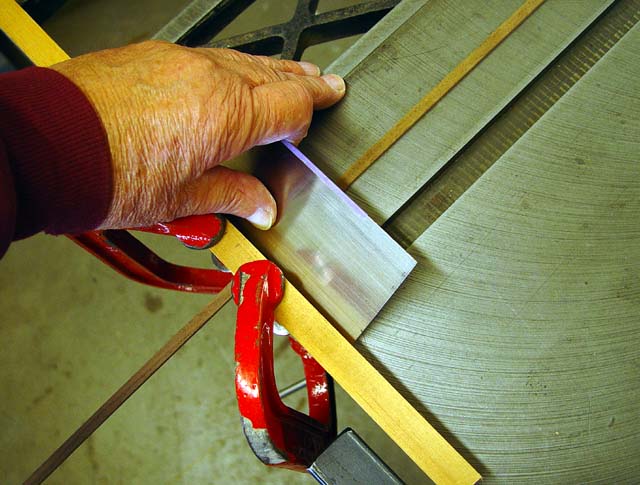

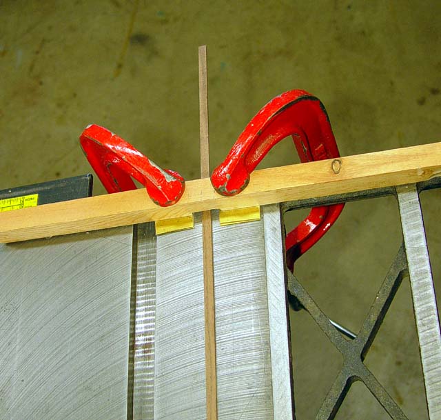

Since I don't have a drum sander, I use a regular cabinet scraper to reduce the thickness of bindings. The binding strip is pulled under a scraper that is supported by brass shims which control the finished thickness. I don't remember where I saw this tip.
Ray

Ray, I like that! Simple, effective, and it all breaks down and is out of the way when you're done.
JJ--I think your visual journal is a great idea. No hunting for information is necessary. It's all right there on one big page.

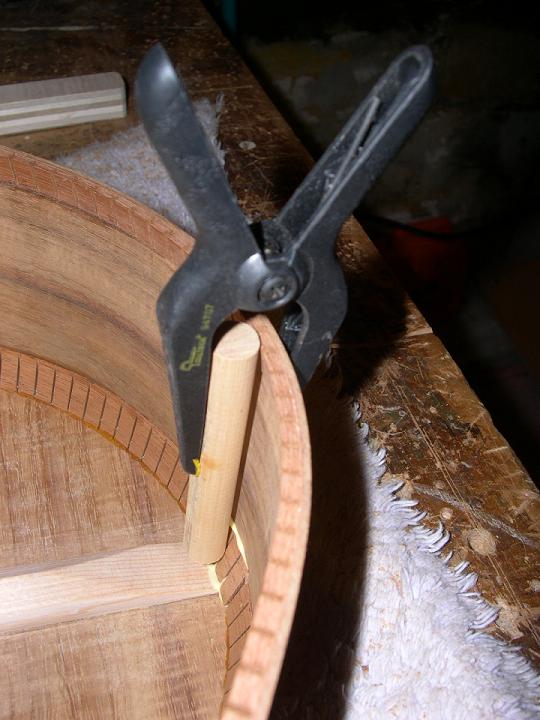

Here's one way to extend the length of your clamp. I take a 1/4" dowel and shave one side flat then it can be used to extend the length of the clamp by cantilevering it as such when gluing up those hard to reach places.

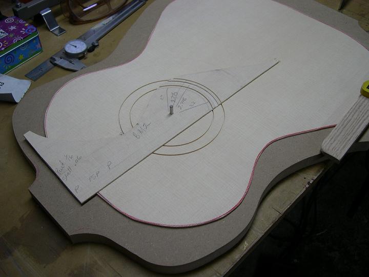

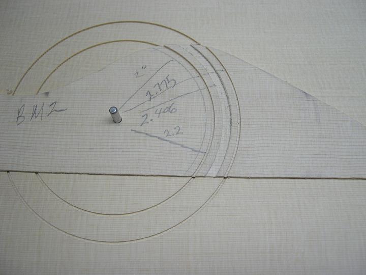

Another thing I do is use a scrape of wood (top) and layout the rosette-cutting pattern. I can then quickly set up router for each pattern very quickly.
